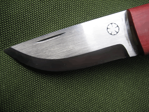

    David's knife is a rather different thing; part from the obvious aspects of its foldyness. It is has a lot more gravity It is heavy knife. The blade is 3mm thick. The brass liners are substantial and micarta is no lightweight material. It has a semi halfstop. A half pause, perhaps, which is very appealing. The blade stays very much open when it is open, and closed when it is closed.
    Moreover, and I may have this wrong, but David uses CNC to produce the parts, and this might account for the finest match of the back of the blade where it meets the backspring that I have ever seen. I just sit around looking at it. It is a wonder of precision – as indeed is the whole knife
    I understand that David also makes lighter knives in a similar pattern. I think I would like one of these at some point in the future, though most certainly not instead of this one. The weight of this knife really lends a quality of confidence to the knife when in use, especially when, say, putting a point on a stick, for example. It really feels like a tool, this one.
    Jacket wear, I would say, rather than jeans pocket wear, I thought at first. But I ran up a little grey suede, fold over sheath for it. Where the grippiness of the suede clings to the lining of the pocket, this helps greatly in keeping the thing comfortable, and just seems lighter that way. I understand Rapidboy and David are working a design for a more robust sheath for these knives.
    The tip of the knife is rather more assertively reinforced, and II think this underlines a different character for the use of the knife. As capable as the Kallioniemi puukko, there is a sense that this is conceived as primarily a wood working instrument, and available for other things. The Kallioniemi feels more like a knife that tries to sit between the demands of woodwork, food prep, filleting and other utilities in a more equable manner. Though, I should say that this positioning of the intention of the knife is not the grounds for any quality judgements. They are simply different there. I’d say that the Hull reminds, if such a near unique knife reminds of anything in particular, of the Roselli UHC knives.
    Proportionally the breadth of the blades differs, too. The blade of the folder is about three quarters of the length of the puukko. However, it is maybe half as broad again. This allows for that pinch grip to be used for closer work, and is really very well judged in that, leaving the entirety of the zero ground edge available for work.
    Having said that I like the barrel shape of the traditional puukko handle, I should also say that I am not a great fan of this on shorter, stouter knives. David’s knife is a full sized, short-bladed knife, much like a shorter version of the Roselli Carpenter, only bendy. So, for the kind of jobs that this sort of shorter blade is good for, the little pinkie kick in the tail of the handle is really very useful, and it goes without saying perfectly conceived and executed here.
    One thing surprises me, I think. And what I am surprised by, is the littleness with which the issue of the handmade/CNC elements of these knives is pat of the apparent meanings of these knives. They both feel handmade, and equally, I suppose, organic is the word. The CNC bit, seems to be a total non-issue, and I think this is an enormous contribution made by David in the design of these folders. It just goes to show that, when done sensitively, the sense of the knife lies in great measure in the conception of it. That said of course, the fact that Joonas Kallioniemi has hand ground the blade, and hand fashioned the handle of this knife is really evident. This is not so much in any apparent errors. Where they are, they are tiny. More it is in the something like the handling of the tip of the knife, which is so kind of spot-on!

    A pair of contrastable details are in the tails of the knives. The peened and ground rivet work in Joonas knife is a compelling. A traditional element in the manufacture of such knives, frequently seen, but wonderfully precise here. But, would you just take a look at the lanyard sprue that David has devised for this folder? If there is a moment where this knife looks like engineering, it is here. Crisp, succinct, fabulously limned in, this element of the knife is integrated into the overall construction of the backspring. What you can also see, and which is rhymed at the other end of the handle, is the filleting in of the brass of the liners. It is transfixing. The knife is made of that kind of resolved and considered consistency. In fact, I think I will take some better pics of the way that those liners show at each end tomorrow.
