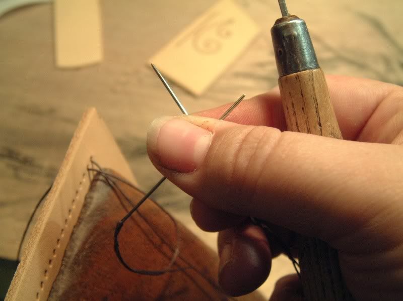

    Ive put this together as it was the way I was taught to stitch by a guy who had something like 60 years of experience in the saddlery trade. I hope some of you find it interesting!

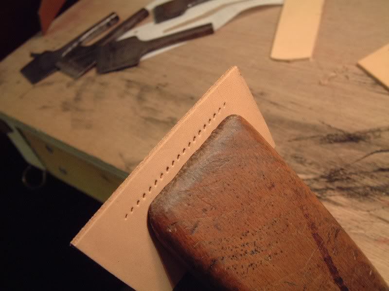

    Lets set the scene, I am sat on a stool with my clams between my knees and my bit of leather set into them so that the prick marks are on the right hand side as you look at it. I'm mainly right handed so will go with that, just reverse it if you are left handed.
    I hold the awl in my right hand and make sure that the diamond shape of the blade is angled away from me slightly.
    I push the awl through the leather trying to ensure I dont twist it too much. The diamond shape of the awl should line up with the angle of the stitch as its marked.
    I push the awl through the leather then as I bring it back out, I follow the blade through the leather with the first needle coming in from the left hand side.

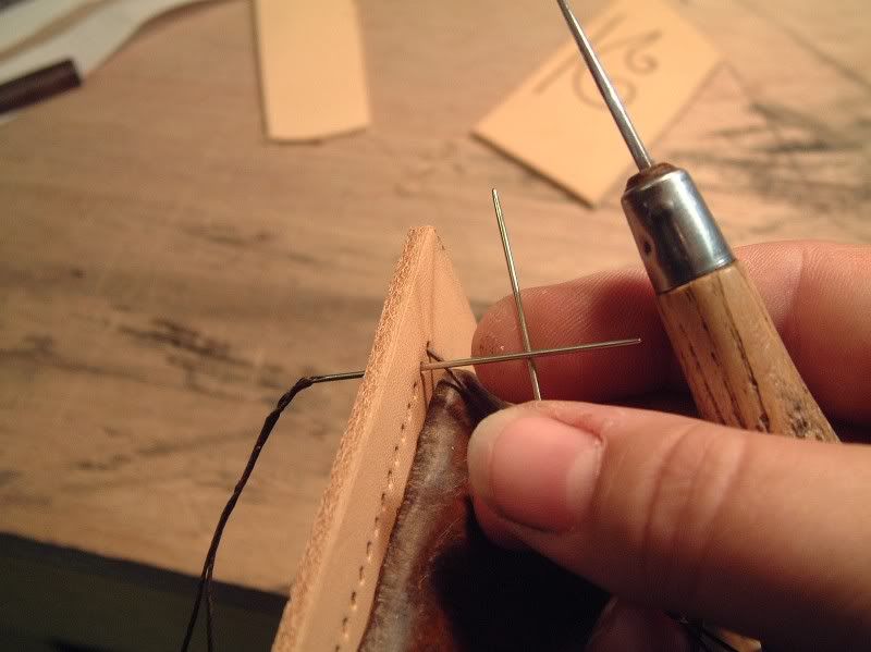

    As this comes through to the right hand side I place the needle I have in my right hand, behind the left hand needle to form a cross. I pull the left hand needle out so that about 2 thirds of the thread available to that needle come through the leather.
    I then pivot my hand slightly to turn the cross so the needle on the back (the right hand needle) is ready and push the right hand needle into the hole.

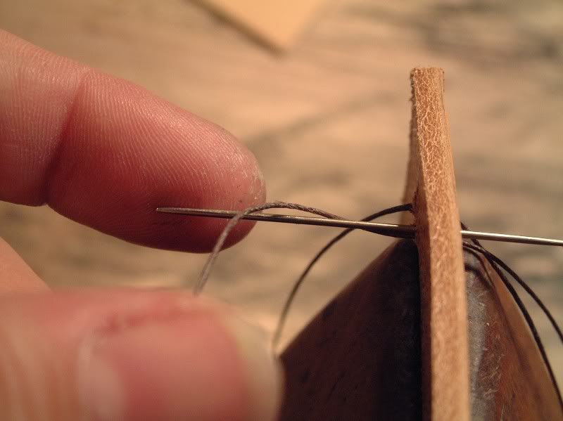

    As I push it through I use my left hand to pull some of the thread already in the hole back through. This prevents the needle from splitting the thread.

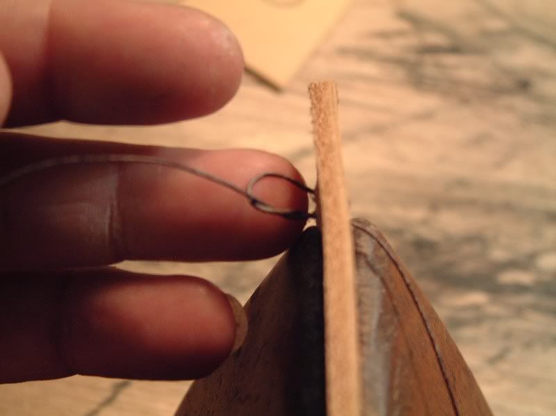

    Just before the needle exits the left hand side of the leather, I pass the thread I have just pulled back through over the needle. This creates the knot inside the leather.
    Pull both threads firmly but excert slightly more pressure on the thread that exits the right hand side of the leather.
    As you are pulling both threads tight, pull your left hand somewhat upwards and your right hand somewhat downwards.
    Hopefully this will give you a slanted stitch thats knotted inside the leather, this is fairly important as it means the thread swells slightly inside the leather, helping it keep together if the top of the stitch is worn off.
