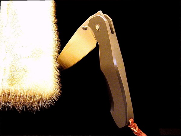

    Does anyone know what type of braid is on this lochsa's lanyard ??
    not a good pic i know but it's the best i could find

    there are a few pics on S cooks website and they don't show it too well
    thats slightly better if only for a side on view

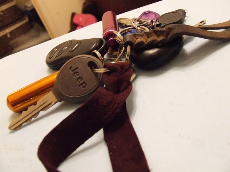

    Right, first picture illustrates passing the strip of suede through a ring and then putting in a cut on the lower section of suede.

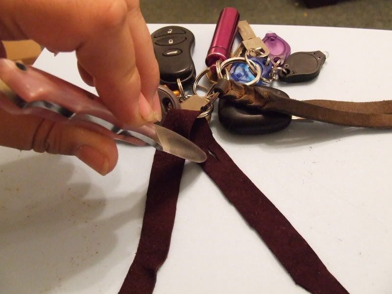

    Second picture, shows the top part of the suede, passed through the slot to then become the new lower section of suede.
    Picture 3 shows cutting the new slot in whats now become the lower section of suede.

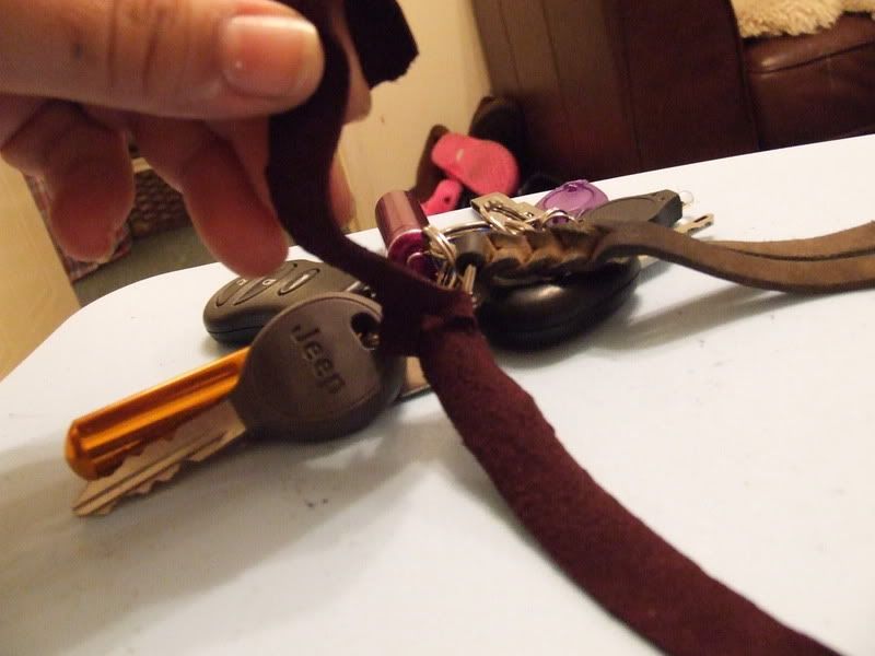

    Picture 4 shows the "braid" forming

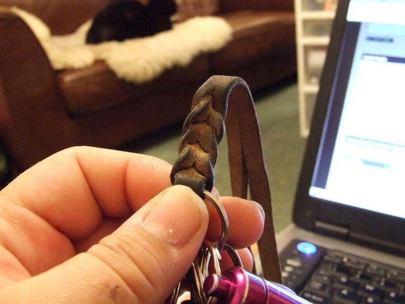

    Picture 5 shows the cutting of the next slot, again in the lower section of the suede.

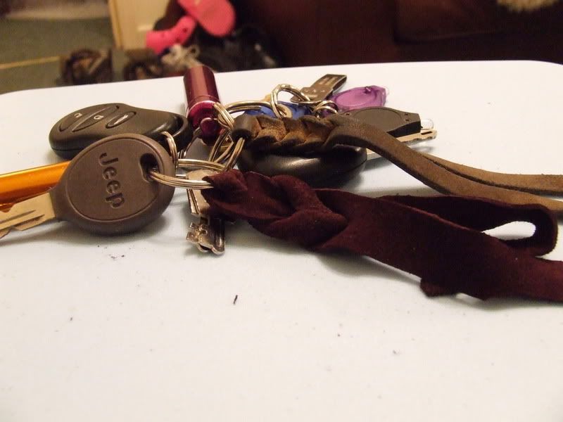

    Picture 6 shows the braid again after the top section has been pulled through the lower section.
    I hope this all makes sense Its getting a wee bit late so if anyone has a problem with my instructions, I'll see if I can help you tomorrow
