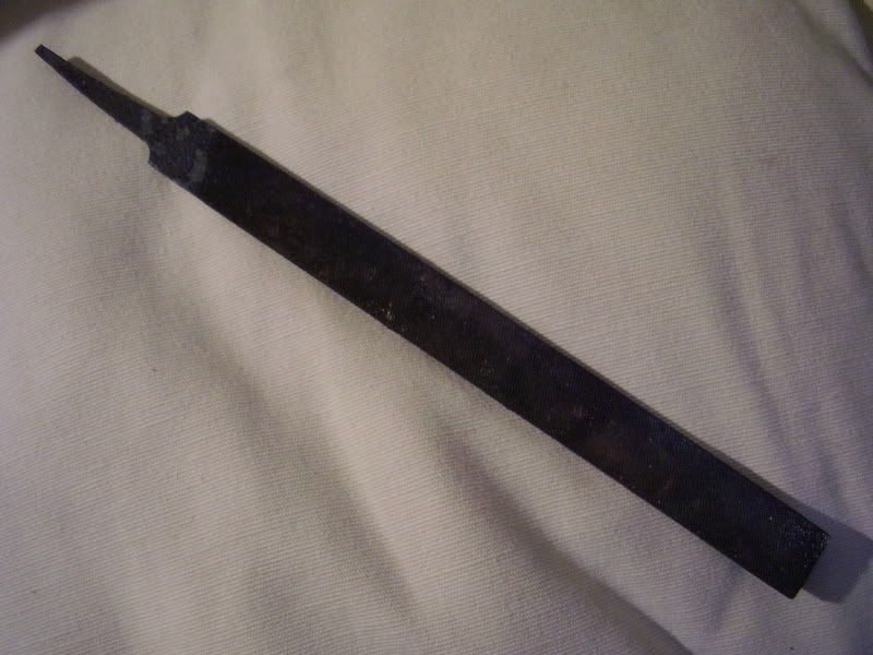

    First take a file (old, cast, Sheffield, Stubs there are many indications) I preferr flat ones, but you can use tapered if you wish.
    Whack it inna forge, take it up to critical (no higher) & soak for a bit, then dunk it straight in vermiculite (available quite cheaply from nursery/pet places) Leave it overnight:

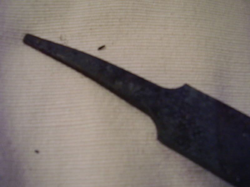

    See the scale around the tang? & the greyness, this is good
    Next grind off the tang (if you're doing a traditional(ish) style tanto that is) otherwise, do what you want with it.

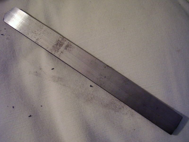

    Grind off the teeth (if it has a smooth edge, this will be your edge, if not, take the teeth from at least one edge) I used my new baby, but you can use anything you want, files, angle grinder, belt sander... Just get rid of them

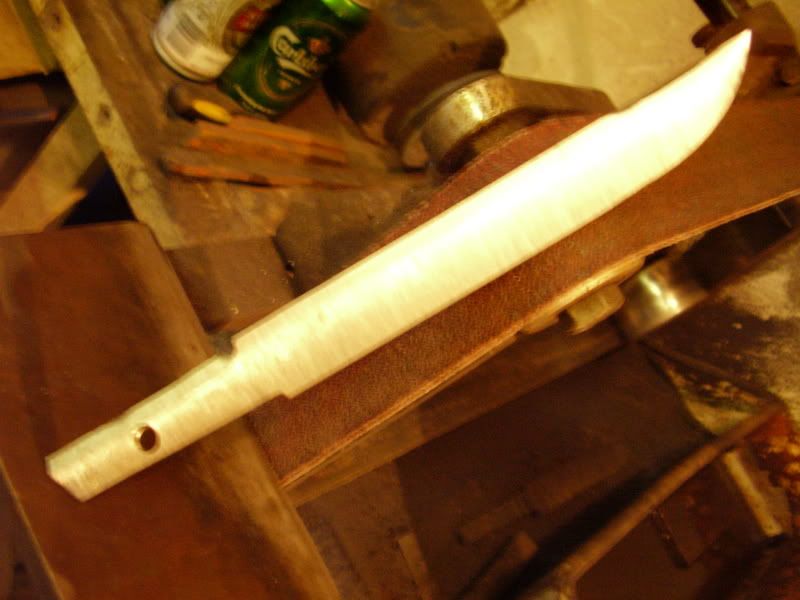

    Next is the shaping:
    first (well for me anyhoo) is getting the tip right, alsom, at this stage you might want to drill for the peg thingy (it'll be a flat surface, but many of you may, like me, want to wait till the tang's formed)
    At this stage the edge is a touch under 1/16" (mebbe 3/64") I'll be taking it no thinner, this is just a tutorial, not a "watch Unca Tolin make a mess of it" by numbers

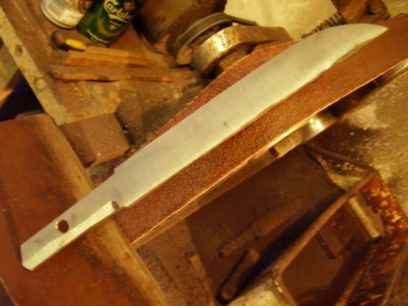

    Re: Hamon from a file
    It's a flat grind, but we'll be convexing it a bit later on

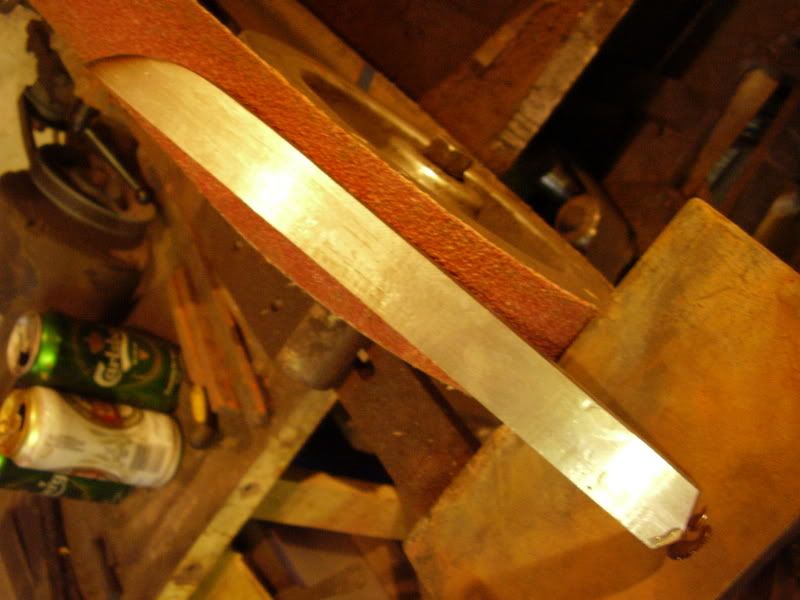

    Colin - sorry for the dumb questions but some of us are real beginners when it comes to grinding blades. Do you just freehand the flatgrind or do you mark the blank in any way to make sure the grind is straight and even?
    Quote Originally Posted by Pikebite View Post
    Richard, I just do it freehand, but many of you won't be able to do that just yet (plus you might not have a KMG)
    I grind up to the thickness I need on an old belt at about 40degrees from the edge (you don't wanna use a fresh belt at this stage, cos the 90degree corner will strip your nice new 60grit aluminium oxide bits straight off the belt)
    Then go to a fresh belt & grind it flat (if you use a push stick, mine's a nice piece of ebony you'll be able to vary the angle of the grind easier by applying more pressure to the part that you want to grind off, if you see what I mean)
    I've only gone to 80grit on this, mainly for speed, but also to give the clay something to grip on
