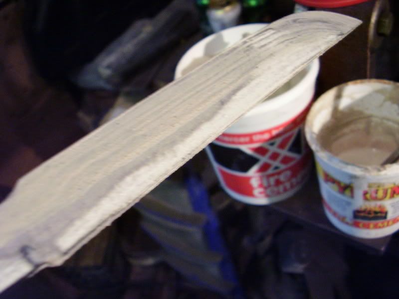

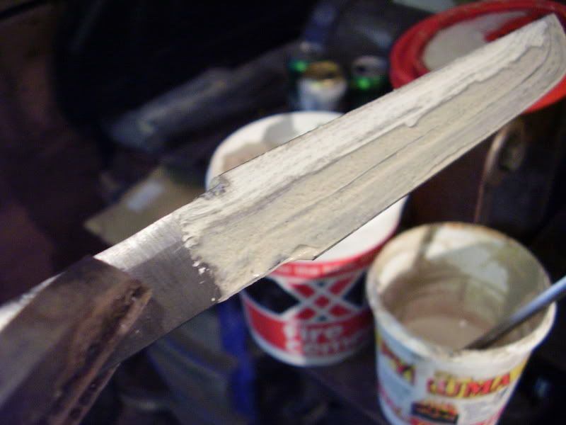

    OK, so, we have a warm, ground (80grit) blade, annealed, drill & profiled, now we need to clay it:

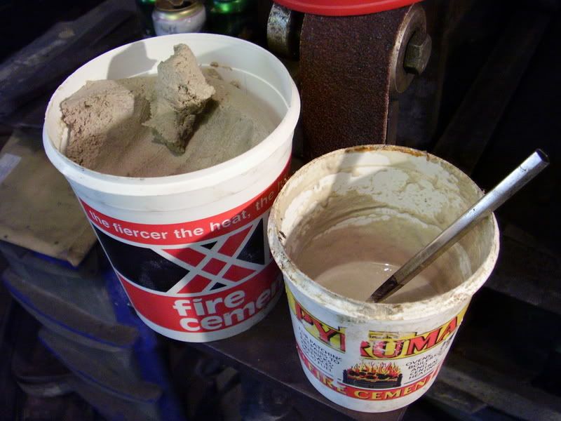

    I use fireclay (Homebase, B&Q) made by Purimachos (Peter has their details somewhere)
    Take a good dollop & break it up into smaller chunks, put into a seperate pot, add water & mix till you get a slurry:

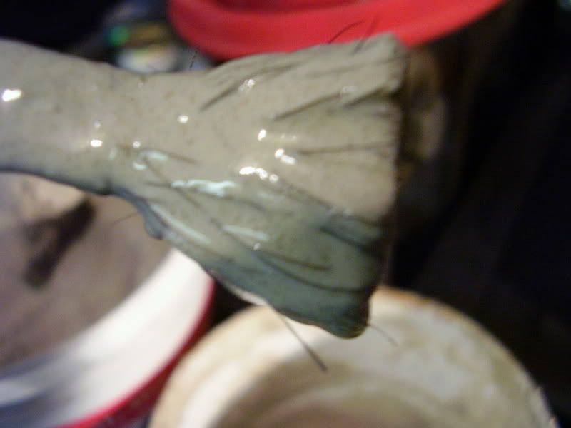

    I use various implements to add to the blade, foremost of which is my brush, I'll also use a plastic knife inna bit.
    Brush your blade with the slurry all over:

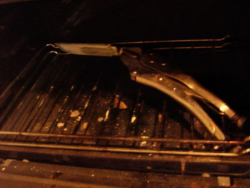

    I sue molegrips to hold the blade in such a way as to only allow the edge to touch anything
    Then back inna oven:

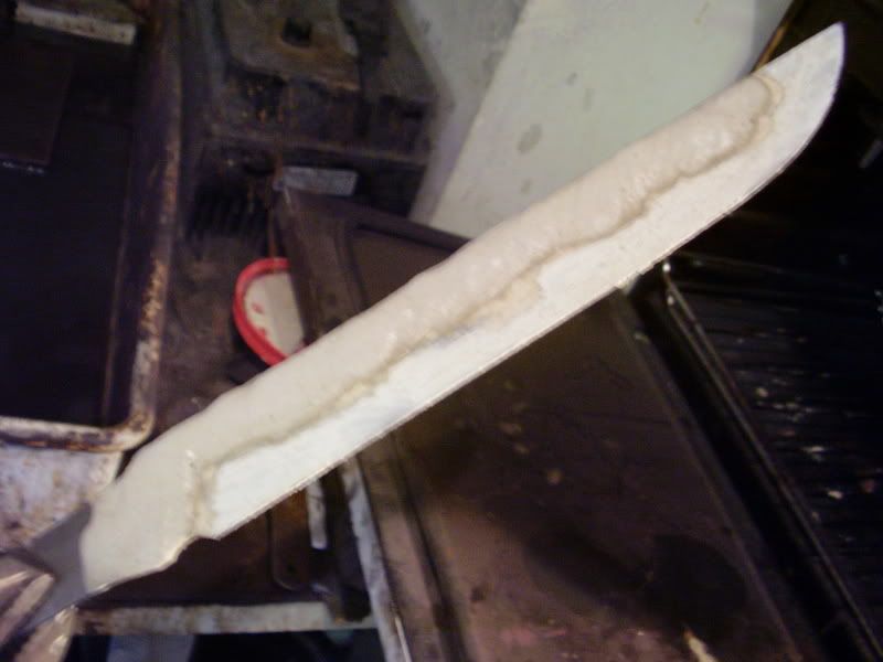

    Keep adding layers of clay to the spine from about 1/2 to 2/3rds the way up the blade, don't forget the area around the tang, we don't want this to get hard
    Make sure each layer is dry before adding the next otherwise it will retain moisture & blow up like a balloon inna forge, ruining the whole thing.

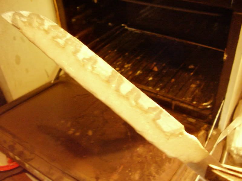

    initially, for now, we add little rat's tails with the aid of my plastic knife making blobs near the clayed spine & drawing the knife towards the edge.
    It's desirable to have the same spacing & clay shape on both sides of the blade, but don't be anal about it
    Unfortunately my camera became full at this stage, so you can't see the other side just yet, mebbe later, when I will be whipping it out of the oven, showing you the tools we'll be using next & giving it a dunk

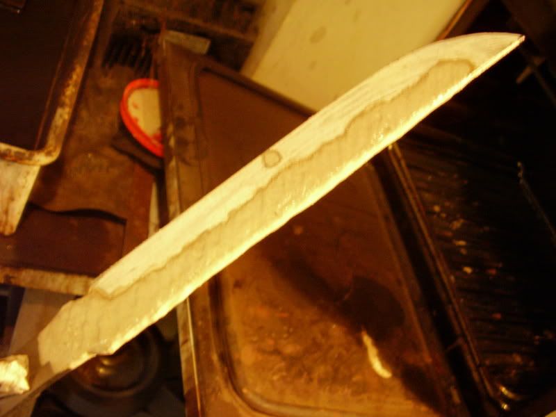

    If you get to the point of looking for a hamon and it either isn't there is isn't what you were looking for can you anneal the blade and start again?

    Quote Originally Posted by Kane View Post
    Oh yes Kane, in fact, don't even bother annealing (that's only to make working the blade easier) just re-clay & go again (assuming of course, that it hasn't warped at all, in which case, re-normalise, straighten, normalise again, then go again)

    Re: Hamon from a file
    If you go to the "One for Mik" thread & see the failed hamon, I just did exactly that to produce the nice one from the same blade
