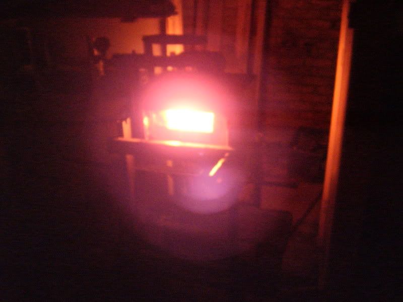

    Okey dokey, now here were we?
    1 hour temper at...
    ...ooops, missed some

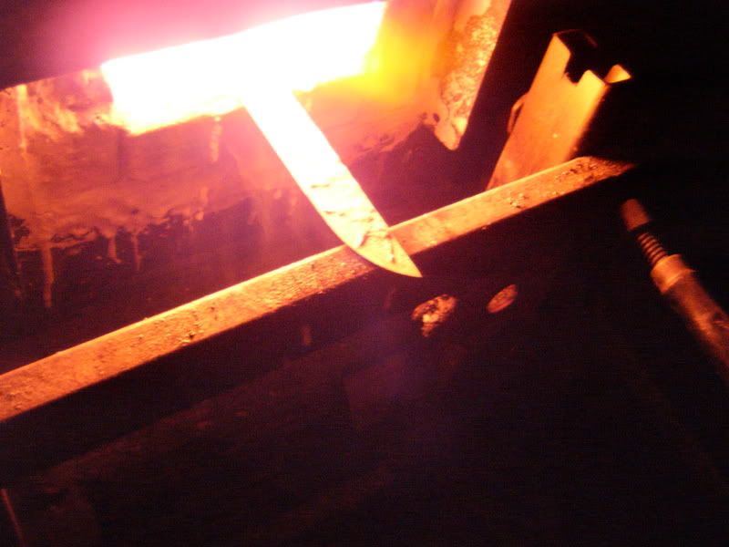

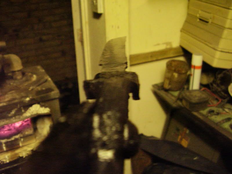

    After the clay's dry & applied as you like, we'll go to the forge.

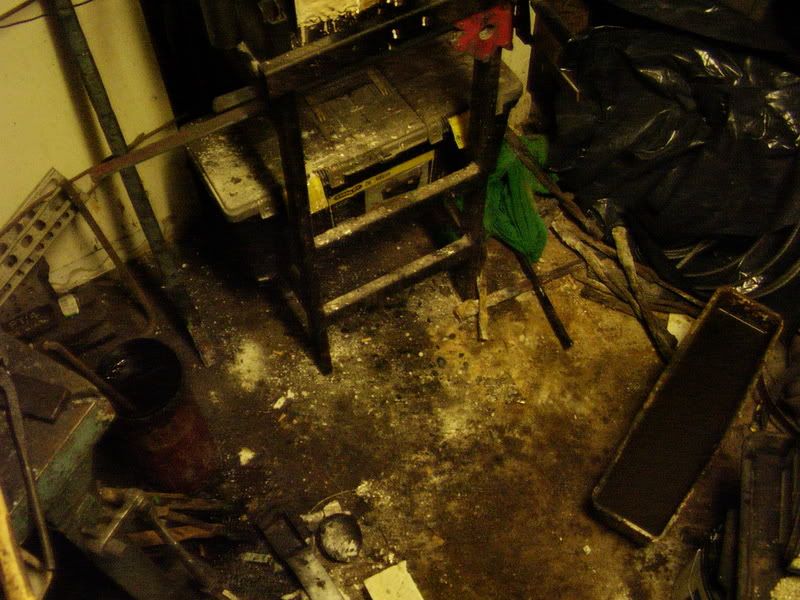

    Make sure that your setup is free from clutter & is ergonomically free flowing (forge to water quench, water quench to oil quench, oil quench to file (more on this later) file to tempering oven)
    Alternatively, you can forget all of that guff & get used to a certain method of negotiating alla mess
    the forge is inna middle, water quench (wallpaper paste trough) is onna right & oil quench is hidden inna darkness onna left

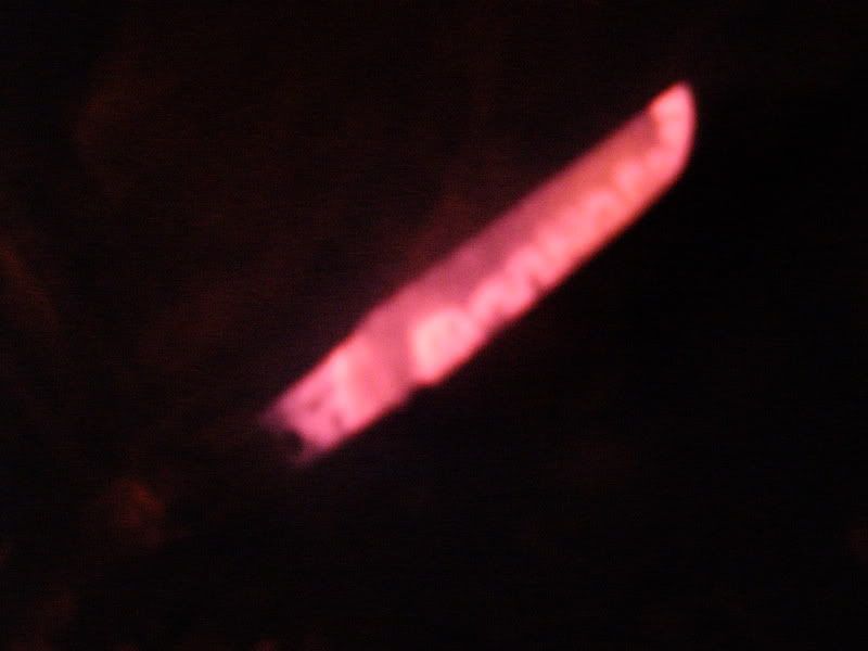

    Forge getting hot:
    Tang first:
    Not quite hot enough:
    's got a curve (sorry, I can't take pics of the quench 'n' stuff) but it got to critical, got edge quenched for a couple of seconds, then straight inna oil, back inna water to sizzle, then over to the pre-heated oven

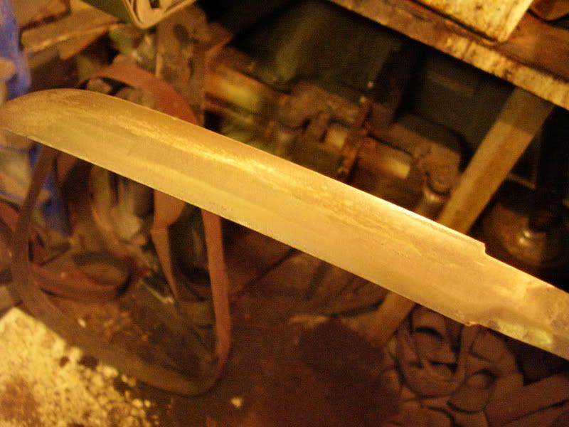

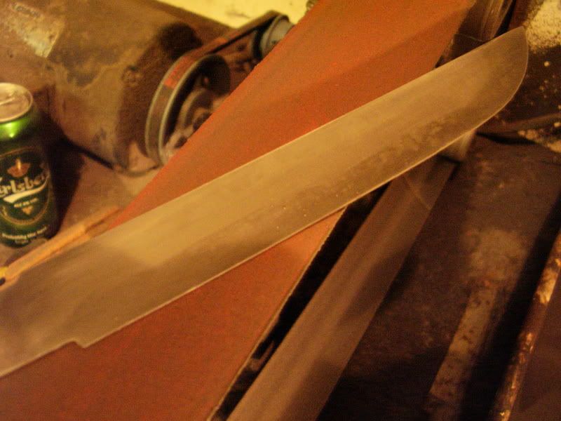

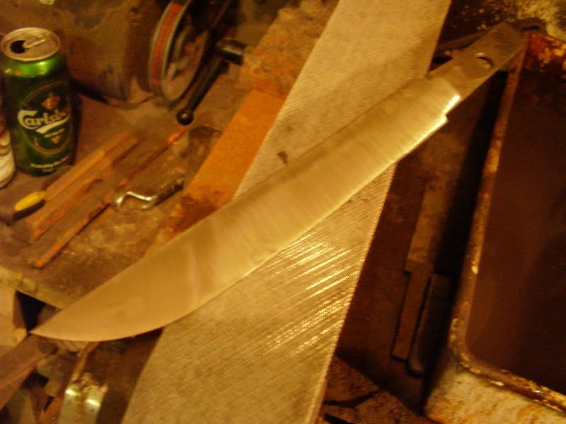

    80grit after tempering:
    120grit Trizact:
    400grit:
    I've since taken it to 1000grit (with a quick detour via 600grit) & will be polishing & etching inna bit
    Eric & proud!

    OK then, less than 12 hours ago, I had an annealed file & a request for a tutorial.
    Well, after Sanding to 1000grit I went straight to polishing (mousemat backed Autosol) & etched (warm vinegar, orange juice & washing up liquid) just rubbed it on
    A quick wipe with bicarb of soda & camelia oil & here she is, Fuji inna mist
